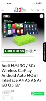

Where I am at the moment is to source an upgrade factory unit with one out of 2015 gen 1 Audi r8 and then install a Mr 12V unit. Appears there a few CarPlay units to plug and play with the factory OEm head unit , , but appears mr12v goes through the cd unit data changer lane and hooks directly into the most fibre optics and eliminates the hissing noise from other units such as carsara/ navifly/ one from nevera auto in brissy.
Then are there any traps for young players eg left hand hand drive vs right hand drive upgrade Navi units / PIN codes if not available ( any hacks) , any vcdS coding requirements for upgraded units / discrete microphone positioning/ factory rear camera hookup and maintenance of guide lines hacks / possible hookup to a bew front canera upgrade
No I am looking to upgrade my rbse to a 424035192J rbse unit which has a media button . The hook up to a car play module. That unit looks like a Acarnavi standalone unit replaced unit from china
